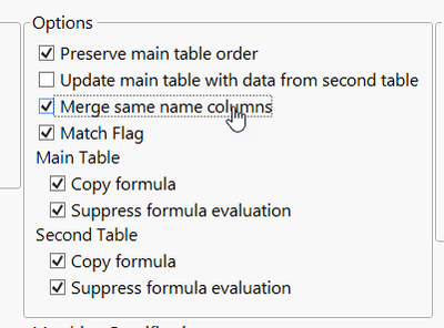

hogi
Level XIII
Re: Best Practices for Repeated Joins/Updates in JMP Scripts
Have you tried to activate  "Update main table with data from second table"
[no new columns - update any matching row]
or "Match same name column"?
[similar to the first one - but adds new columns.]
