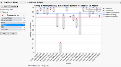

You could try using this script I made for my Non-pro users to try and squeak out some NN tuning.  This allows you to see which model does the best with different Qty of Tanh nodes as well as try different validation percentages.  It also shows what variables are most important across all the models.

I'm impressed by some of the visuals that are very clear and easy to understand, for example this one enabling to evaluate predictive performances and robustness/generalization properties to a validation set :
A little recoding of the informations from this attached table could help visualizing performances trend depending on the number of TanH activation functions/nodes :
Maybe some parts could be interesting to consider for updating the Neural Network Tuning add-in @scott_allen ?

These are some nice visuals. Its really challenging to summarize so much information into simple graphs and @shampton82 has some really nice examples.
I am working on a similar add-in for Torch right now. There are even more parameters to screen and tune and I think similar visuals might work well when scanning across model types and activation functions.
