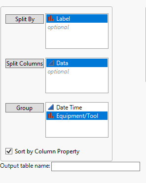

Hey @PowerMeerkat608
I had this same problem and the way I came up with combining the tables was to stack them and then split them. I used a date time column as the unifying item between them all.  When you stack the tables, all your columns of interest will go into a "Label" column and the data values will be in a "Data" column.  The extra columns you keep are just additive to the tables.  The key is to rename the columns to be as consistent as possible, so in my case I renames columns listing pieces of equipment to "Equipment", that way no matter how many data tables I join I will only have one column with equipment.  After you have stacked all your tables, concatenate them then split them back out so that all the Columns in your "Label" column are now their own column again and thus you can apply Column Spec properties and do all your fun SPC stuff.
Hope this helps!
