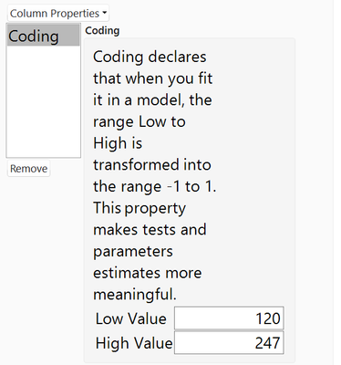

The range that BayesOpt is set to explore is agnostic of the actual entries you've used - you just need to go on each column for each factor and set 'Coding' to say the limits that you want explored (see screenshot below).
