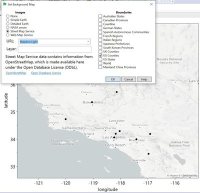

I'm using JMP17, and none of the boundaries in the "Set Background Map" window show up on the graph (e.g., US Counties, US States, etc.). I changed the color and thickness of the boundaries in "Customize," but they still do not appear on the map. I didn't have this problem on previous versions of JMP. Any help is appreciated.

I simply added latitude and longitude to the x and y axes, then right-clicked on the map > Graph > Background map.. and enabled "Street Map Service" and "US Counties," but the county borders do not appear on the map. I tried it on two different machines and they both have the same issue. See attached.

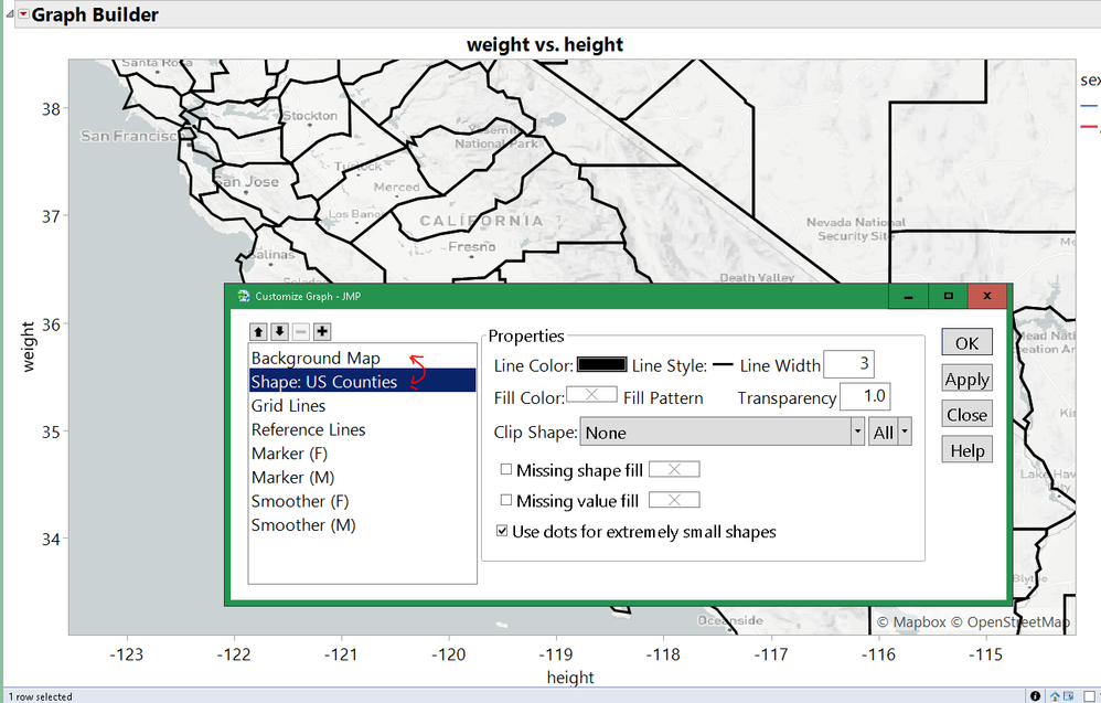

Craige_Hales
Re: Background Map Boundaries
make sure the drawing order puts the base map first, then the counties.
The background map will hide anything that is drawn earlier.The background map will hide anything that is drawn earlier.
