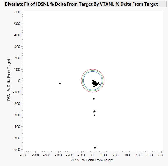

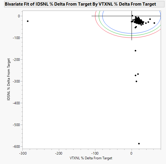

As a follow on to the discussion above, I would like to automate the scaling of some plots to be symmetric about the zero value on both the X and Y axes.
I'd like to have this
automatically output as this.
The code that got me here is included in the link above

Re: Automatic Scaling Matching X and Y Axes
Thanks and you are right with what you say, I think I'm not expressing the question properly.  Missing values in X are ignored when figuring out the maximum of X.  The partner Y values on the same row are not missing and therefore not ignored.  I should clarify that I'm iterating through columns in a data table and automatically plotting metrics that are connected.
This script might pick a voltage threshold and plot it against the respective current value if that gets selected.  When this rescales at the end a missing value in X for example will cause there to be no data point on the graph, however, the partner Y value could still set the scale of the graph.
To ensure the plot contains the 100 value on both axed, I did modify the matrix to include 110 with |/110;

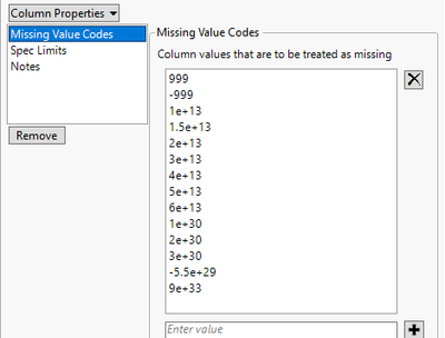

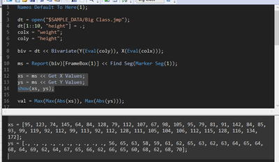

There is one small thing that I came to realise.  In some instances, one of the ys or xs matrices has missing values because it has been given a missing value code.  The partner matrix values may not be missing and can be included to set the scales.  Is there a way to eliminate values from ys if the row is marked as missing for xs with the same elimination of xs occurring when ys is a missing value.
Slán
SpannerHead
Slán
SpannerHead
jthi
What does "marked as missing" mean in this case?
If you wish to keep the other value, I think that should still work even if the matrices have missing values.
-Jarmo
SpannerHead
Level VI
I have a lot of error codes that are numeric to preserve the data type for the column.  I need to turn a blind eye to those in the analysis.  However, if either X or Y are marked with a missing value code and the partner is not, the scales can be set by data that is not actually plotted on the graph
Thanks for the great help.

jthi
As you know the columns you are using, you can use Col Min + Col Max to get the minimum and maximum values (they should respect Missing Value Codes). Then use combination of your values, Abs() function and Max() function to get your value to use for x and y axis
Names Default To Here(1);
show(Col Max(Column(dt, "height")));
Column(dt, "height") << Set Property("Missing Value Codes", {70, 69, 68});
but I also think that Bivariate shouldn't plot those points at all if they have been ignored by Missing Value Codes
biv = dt << Bivariate(Y(:height), X(:weight));
ms = Report(biv)[FrameBox(1)] << Find Seg(Marker Seg(1));
xs = ms << Get X Values;
ys = ms << Get Y Values;
val1 = Max(Max(Abs(xs)), Max(Abs(ys)));
biv << close window;
Column(dt, "weight") << Set Property("Missing Value Codes", {172});
val2 = Max(Max(Abs(xs)), Max(Abs(ys)));
show(val1, val2);
-Jarmo
One option is to use some matrices to check for "valid" rows, get values only from those and then calculate max as before.
m1 = Column(dt, "height") << get values;
m2 = Column(dt, "weight") << get values;
valid_rows = Loc(V Sum(Is Missing(m1 || m2)`), 0);
val = Max(Abs(dt[valid_rows, "weight"] |/ dt[valid_rows, "height"]));
-Jarmo
