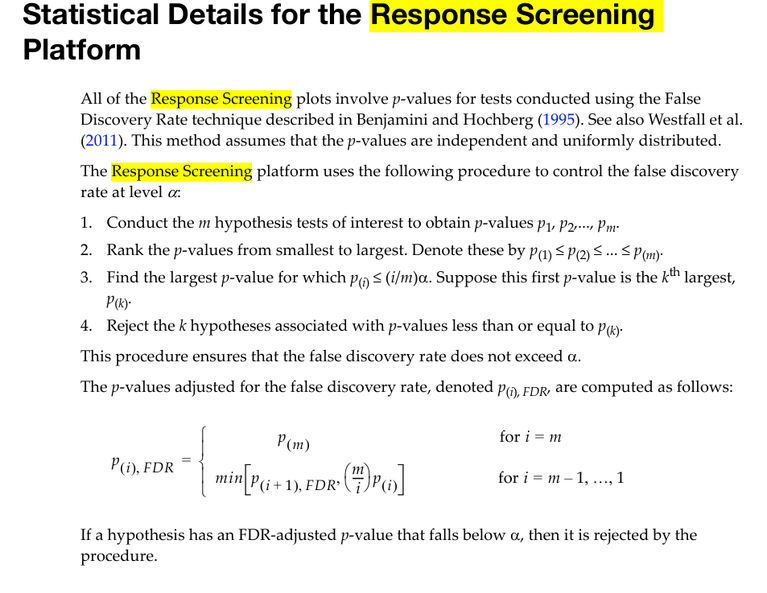

txnelson
Re: What is the statistical method used in response screening for means difference test?
Here is the information provided in the Predictive and Specialized Modeling book on page 539 in the JMP Documentation Library under the Help pull down menu
Jim
The tests are the same as those available through the four platforms launched by Analyze > Fit Y by X. See this other section of the documentation.

txnelson
Jim
