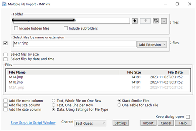

Also you might consider using Multiple File Import. Either combine all the tables into single table and then separate them into subsets using source column (create new column based on source column for the groups you want to have) or run MFI multiple times using wildcards * (match zero or more characters), ? (match exactly one character) and ; (separate different file name patterns) to get all single group with one run of MFI
-Jarmo

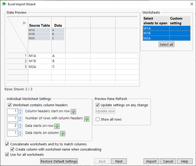

Re: Automate concatenating data tables based on name
I don't think this can work as they all come from the same excel workbook. I open this workbook and each sheet becomes a new data table. Is there a way for this to work?
jthi
If it is just a single excel file you can use Excel Import Wizard.
Enable "Concatenate worksheets and try to match columns" and "Create column with worksheet name when concatenating". After you have data in JMP table, create grouping column and create subsets as needed.
