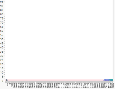

I'm pretty new to JMP and I currently have a bunch of control charts for a data set I'm analyzing. They're all saved to the data table and every time I run them I have to manually drag the y axis until the range is correct. Is there a way to edit the script so this is done automatically?

I edited that part of my script but its still resulting in the same thing.
It ends up looking like this:
SendToReport(
		Dispatch(
			"test",
			ScaleBox,
			{Min(), Max(), Inc(),
			Minor Ticks( 0 )}
		Dispatch(
			"test",
			ScaleBox,
			{Format( "Best", 12 ), Min(),
			Max(), Inc(), Minor Ticks( 1 )}
