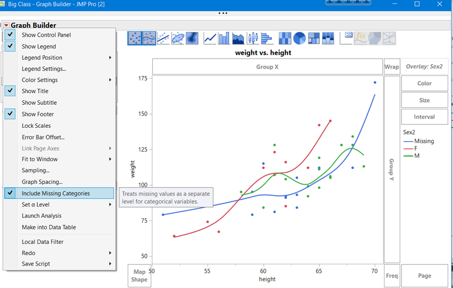

I am using the graph builder and would like to overlay a column on my graph, however when I select the overlay, rows that are empty for that specific column I am overlaying disappears on the graph. Is there a way to add an overlay for empty cells as well?

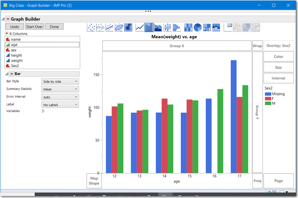

You did not mention which version of JMP you are using. The picture below highlights the option Include Missing Categories. This example is Big Class, where column Sex2 is the same as sex with about 25% of the rows where no gender is specified.
