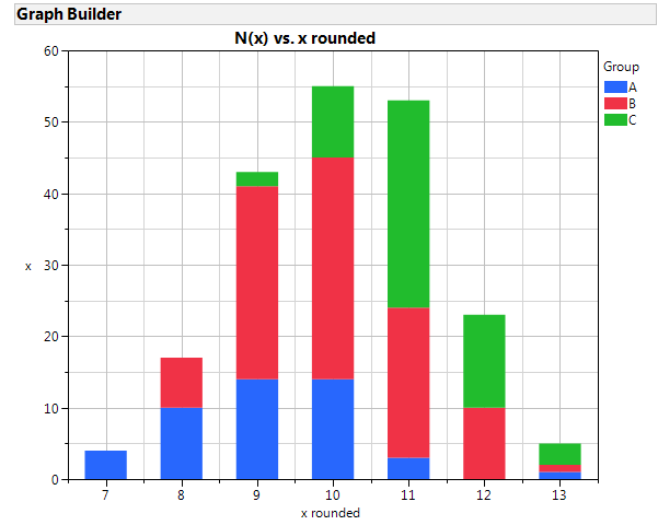

I am looking for a function to generate a histogram with color information on data groups like this:
However, in this case I needed to bin the data myself. Also the bars don't touch like normally in histograms.

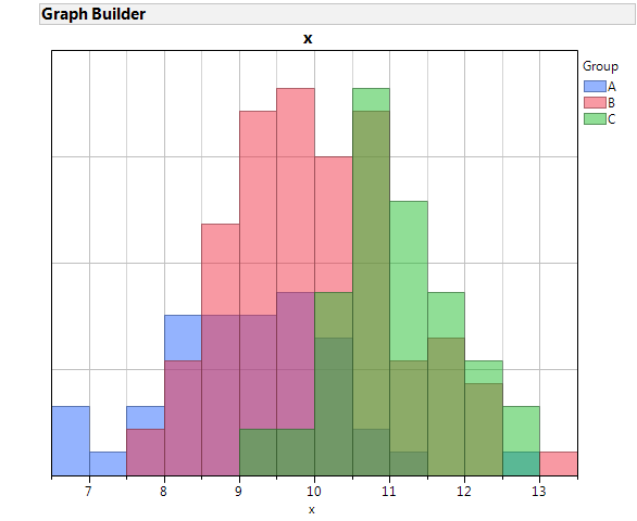

I know the function in graph builder generating the type of histogram shown below, but here the istograms are not stacked but superimposed on each other, and almost impossible to read for many groups for many groups:

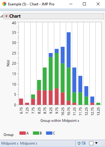

dis << save( Level Midpoints );
// Change the X axis modeling type so the bins are equal distance groupings
dt:Midpoint x << modeling type( ordinal );
// I use the Chart Platform for this because I developed the method long
// before the Graph Builder was available
Chart( X( :Midpoint x, :Group ), Y( N( :x ) ), Stack Bars( 1 ), Bar Chart( 1 ) );

Re: Auto-generated stacked histogram
Than you Jim
I was not aware of the option to save midpoints from distribution. That of course is a neat way to bin the data.
I guess you answer is that the feature does not exist as a built-in function.
