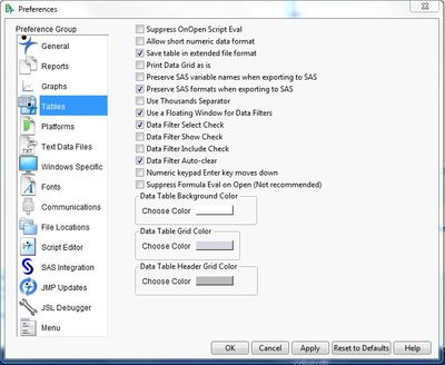

The majority of our customers find this a useful feature, and in fact it was added due to customer requests.  It is easily suppressed by selecting Preferences->Tables->ODBC Hide Connection String.  This could be disseminated to users via a preference file specific to your organization.

It doesn't appear to be in the preferences for JMP 10.  It's in the JSL scripting guide on page 480.  You have to set it in JSL.  Here's the relevant part:
Note: When you import data from an ODBC database, a table variable is added that can contain user ID
and password information. To prevent this from happening, set the following JSL-only preference:
pref(ODBC Hide Connection String(1));

before posting this comment I could not find any info about managing ODBC.  My version of JMP 10 doesn't have this option.
