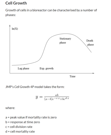

Sorry to give another response that doesn't answer your question - just another observation - you can use the 'Fit Curve' platform to fit a nonlinear cell growth model.

Hi @David_Burnham, thank you for your responses! I actually used the Cell Growth 4P model in the past (for a different purpose) and it did work very well! However, what I'm trying to achieve is quite different. I'm providing more information below.
