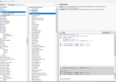

txnelson
Re: Taylor Graph Builder expression
I am not aware of how to get around the Substitute issue.  You may want to explore the Scripting Index Graph Builder messages that can be passed to Graph Builder
Names Default To Here( 1 );
gb = Graph Builder(
	Variables( X( :sex ) ),
	Elements( Points( X, Y ), Smoother( X, Y ) )
gb << Add Variable( {:height, Role( "Y" )} );
gb << Add Variable( {:weight, Role( "Y" )} );
@Georg
Building on @txnelson's suggestion about sending messages to graph builder, this might get you closer to what you are looking for:
cdt = Open( "$SAMPLE_DATA/Big Class.jmp" );
col_lst = cdt << get column names( Continuous, "String" );
gb = Graph Builder(
	Variables( X( :age ) ),
	Elements( Points( X, Y ) )
for each( { yCol }, col_lst,
	gb << Add Variable( { eval( yCol ), Role( "Y" ) } );
The resulting graph builder script is:
Graph Builder(
Variables( X( :age ), Y( :height ), Y( :weight ) ),
Elements( Position( 1, 1 ), Points( X, Y, Legend( 1 ) ) ),
Elements( Position( 1, 2 ), Points( X, Y, Legend( 2 ) ) )
-Scott
