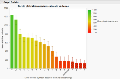

I wanted to design an experiment to screen 18 factors against one response. I now understand that there are more modern, better designs to solve this problem, but at the time I used a 20-run Plackett-Burman design. I completed each run in duplicate, for 40 runs in total. I am attaching a .csv of the anonymised results, where I have standardised the factor levels (subtracted mean and divided by standard deviation).

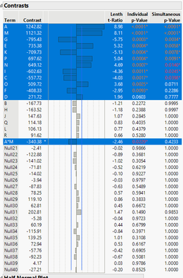

I understand that because Plackett-Burman is a saturated design, I can't try to fit a linear model because the number of terms means it is almost certain to be overfit, so I should use 'two-level screening' (although maybe this changes because I have duplicates?) . I used this option, adding all 18 factors A-R as Xs and the response as Y. Screenshot of results below:
I expected A,M and D especially to have an effect, but I would find it quite surprising if F and K, were to have significant effects. Therefore I thought I would check here if I am interpreting these results properly. I'm especially confused with the fact that JMP adds 'Null' terms as part of the two-level screening. This page in the documentation describes the rationale:
The process continues until n effects are obtained, where n is the number of rows in the data table, thus fully saturating the model. If complete saturation is not possible with the factors, JMP generates random orthogonalized effects to absorb the rest of the variation. They are labeled Null n where n is a number. For example, this situation occurs if there are exact replicate rows in the design.
I do have replicate rows in the design, but when I look at the plot above it seems to me that factors A and M are separate from the other factors, and that factors other than A and M only look significant because of the null terms being added.

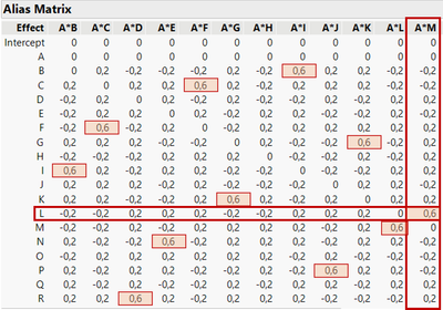

However I wouldn't add at this stage any 2-factors interactions in the model like A*M, since this term is aliased with main effects already part of the model during design creation:
At this stage I would consider using only significant main effects in the model, and realize a design augmentation if you want to identify relevant and significant 2-factors interactions.

To clarify a misconception stated by @Victor_G, the interaction term A*M is not aliased with any main effects. An alias would be identical to another term in the model. Aliases are also said to be 'confounded.'
Aliases occur when two effects are perfectly correlated. This is not the case here. Entering aliases in the same model produces a 'singularity.' A*M can be estimated along with the other terms. A*M is correlated with other terms, but its estimate would experience inflated variance and, hence, longer confidence intervals and lower power.

Analysis of the results using normal/half normal plots (first introduced by Daniel) was for un-replicated experiments.  It is a great way to analyze un-replicated designs as there is no biased MSE for statistical significance.  For normal plots to work, the model must be saturated (every DF assigned). Since you have what may be randomized replicates, it is impossible to assign the DFs, so JMP assigns the null as place holders for those DF's.  You might look at ANOVA, since you may have unbiased estimates of MSE.

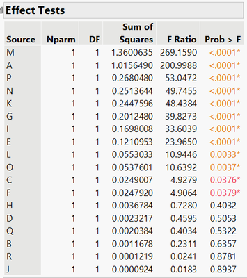

So I used 'Fit Model' in JMP, with only the main effects included, as @Victor_G pointed out (I think @Mark_Bailey is saying that the design would perhaps allow me to investigate interactions, but that I'd have lower power due to correlatons. At this stage I'm not really interested beyond main effects, however). I saw that the residuals in the "Residual by Predicted" plot appeared slightly heteroscedastic (the physical properties of the system that I'm investigating would support this, I'd expect variance to be a proportion of the response, rather than a constant variance for all responses), so I log10-transformed the response and reran 'Fit Model', and obtained the following ANOVA table:
(Reports for both the "Fit Model"s attached)
This seems to agree reasonably closely with the "Fit 2-level screening" platform results.
