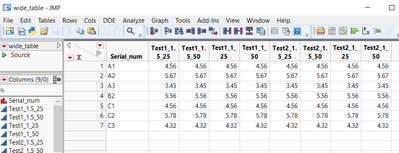

But to use the column properties spec limits, I have to convert to this wide format:
Which I can accomplish with by splitting on a “trial_name” column created for the purpose. So now every item has a row with each trial being a column.

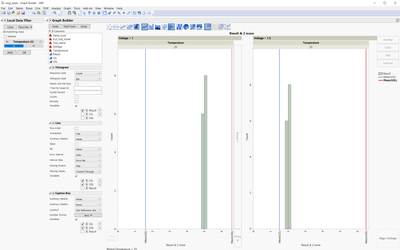

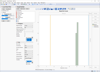

What I want to do is use the “spec limits” which is present as metadata in the tall table. I can and do extract the spec limits into a table, and apply it to a data table, but that only works for the wide table. Each unique trial might have unique limits so I can’t just save 1 upper and lower limit to “result”.
With the wide table, I can run quality reports and graph each trial and have the limits applied properly. But with the tall table, if I want limits on a graph I have to manually, tediously, add reference lines to each graph.

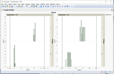

This graph for example Is really good for showing the whole story, but I need to add spec lines. They might have different specs like this:
I can only accomplish this by adding them manually. I need to automate this so manual just won’t do.
