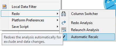

GraphBuilder updates the graph automatically when there are changes in the data table.
For Bivariate, you can enable automatic recalc:
