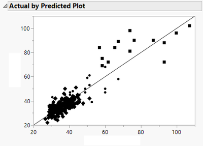

Anyone have add-in or JSL code for adding a 45-degree line and squarify a GB plot?
Hi All,
  I'm wondering if anyone might have available some JSL code or an add-in to be able to take a graph builder (GB) plot and squarify it (set both x and y axis the same) and add a 45-degree line, like how the Actual by Predicted plots often do, see example below.
  As far as I know, GB does not have any kind of option to automatically do this for you, which is too bad, because I often like making graphs like the Actual by Predicted graphs and have the added versatility of the GB platform for adding color or other kinds of formatting to the graphic.
  Maybe this could be on the wish-list for a new feature in GB?
Thanks!,
DS
