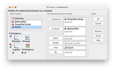

You are on the right path for using fit Y by X for contingency analysis. The data entered is not quite correct.  You need a stacked table. X would be Before/After and Y would be Scrap/Not Scrap and the frequency would be count.
To do this, you would first subtract Scrap qty from Qty Produced to get Not Scrap count. This can be done by selecting both columns the using a right click and choosing New Column Formula>Combine>Difference (reversed order)
I renamed the columns to Before/After, Scrap and Not Scrap.
Next is to summarize Scrap and Not Scarp using Sum within Summary under tables and using Before/After as Group (this is similar to what you have done before). Then stack Sum(Scrap) and Sum(Not Scrap) so you now have 3 columns (using Stack under Tables menu)
Now you can use the new table for Fit Y by X like you did before.
