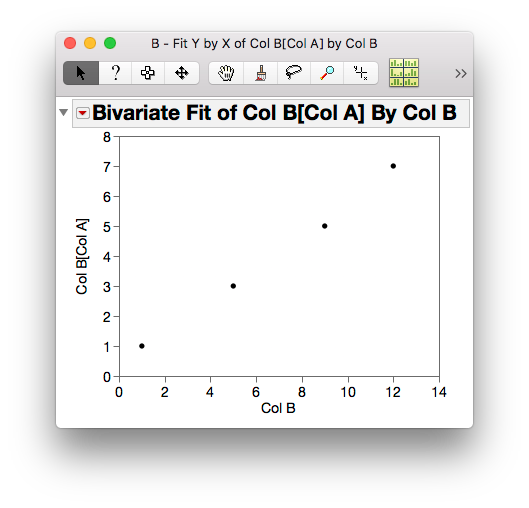

Now in Table B you can execute an analysis like Fit Y by X and be able to analyze Col B in Table B and Col B in Table A without concatinating them. Screen Shot 2017-08-15 at 10.59.52 AM.png
 Here is the resulting analysis. Col B in Table B is on the X axis and Col B of Table A is on the Y, linked together by the Col A IDs. Screen Shot 2017-08-15 at 11.01.25 AM.pngThere is a chance that this is not what you mean, too. If you simply want to apply the same analysis in Table B as you did in Table A you can save the script of a platfrom to the data table (platform little red triangle -> save script -> to data table..) and then copy and paste it to Table B. Then when you click the play button in Table B the same analysis will be run (since you have the same column names).

Yes this is what I meant. thank you
