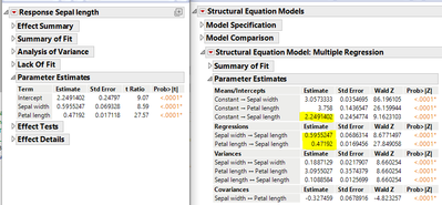

1) Running the script in "Compare_FitModel_to_SEM.jsl" will show you the results of a multiple regression using the Fit Model platform and the SEM platform. You can look at the output side by side to see the same results:

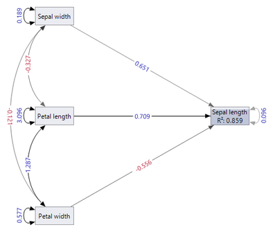

2) The script "Hierarchical_Regression_in_SEM.jsl" fits two models in the same SEM report; the full model, which has all the variables predicting the outcome, and the restricted model, which has all but one (or more) variables without an effect on the outcome. In the SEM path diagram, a regression effect is depicted as an arrow, so you can see the full model has all the effects:

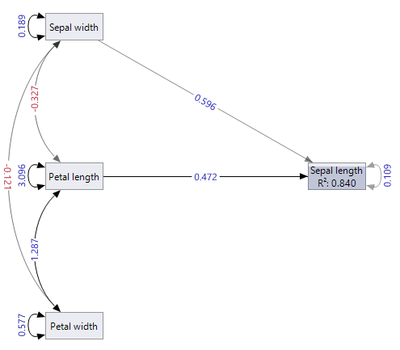

and the restricted model has one effect fixed to zero:
