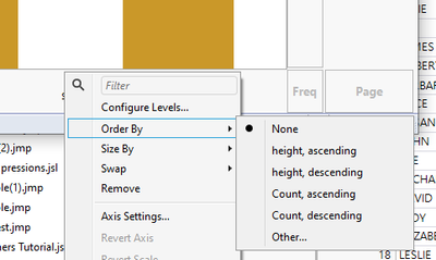

I am struggling to change the order of the x-axis values of my bar chart. How should I do this?

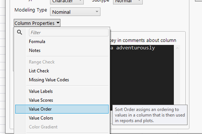

Value Order column property
with value order M before F
Or you can change it by right clicking on the axis, selecting how to order by

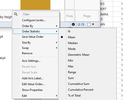

and after this has been done you can change the ordering summary statistic by right clicking on the axis again
