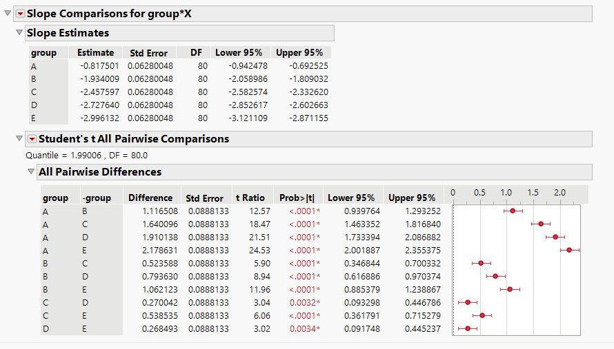

Hi @bbenny7.
I just wanted to add that the ability to do all pairwise comparisons of slopes in Fit Model Standard Least Squares, REML, and Mixed Models has been added in JMP 19.  For example, if I use your data and run a standard least squares regression like @Ben_BarrIngh ran and choose Estimates >> Compare Slopes from the main red triangle menu and turn off Comparisons with Overall Average from the Slope Comparisons for group*X menu, I will get the following report of Student's t All Pairwise Comparisons:
Here is a picture of all the options available for slope comparisons in JMP 19:
I hope this is helpful.
