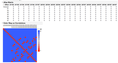

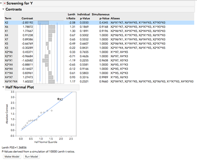

I use the Color Map on correlations and hover over the red boxes to see the alias structure but one can also use the Modeling>Screening platform which delineates the alias. There may be additional ways but I figured I'd share these.

After you create and save your augmented design then just use the Evaluate Design capability to examine.

If I look at the Evaluate Design report, I see the alias matrix which indicates me which interactions are confounded with the main effects.
However I would like to know which two-factor interactions are confounded with other two-factor interactions. How can I get that ?

That is exactly what I was looking for.
