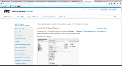

ron_horne
Super User (Alumni)
Re: Adding "Name contains" search bar to Column Dialog form in JSL.
hi Chungwei,
this filter is very useful and is available in most platforms in JMP. is there a reason it is not built-in to the Fit model dialog? it would be very useful there.
chungwei
Staff (Retired)
what version of JMP are you running ?
ron_horne
Super User (Alumni)
hi ChungWei
i am using jmp 11.
in JMP 12 (or any other version it is not available)
this is out of the help documentation: the fit model just doesn't have the red triangle near the list of columns
on the other hand the fit y by x has it (and had it for many versions back)
Thanks!
