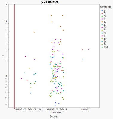

Hello,
I'm having trouble adding a horizontal reference line in my plot based on a column parameter. The code is attached below. I need the reference line to be a horizontal line not a vertical line:

Does the reference line appear if you translate or scale the Y axis to decrease the minimum value shown?  Since your script sets the min to the same value as the reference line, I would be concerned that numerical issues may cause the reference line to be clipped from view.
Re: Adding multiple horizonal reference lines based on columns
The line needs to be horizontal based on the value that is listed for, 'threshold'. I want these so I can automatically create a data filter and see how this line changes.
