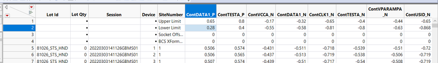

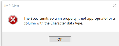

Hi Folks, new to jmp scripting.  I have a script attached that was written in 2012 and now does not function since moving to jmp16, it worked under jmp14.  It basically allows me to read in the upper and lower spec limits for all the column parameters. Below is the error message and a sample of my data file once I have read it in.  Any help would be greatly appreciated.  I did not write the script and the person has since left the company.
Thanks in advance for any assistance.

There were 2 issues.
  1. The value for the variable "Version" had not been set.
  2. In JMP 16, the code stops when it comes across a Character variable.
I fixed both issues.  Rather than checking for a Data Type of Character, I actually check to make sure the Modeling Type is Continuous.  Nominal or Ordinal numeric columns also should not have Spec Limits set.
