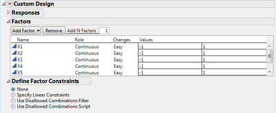

I am creating a design and I want to add one constraint. I have 7 continuous variables and of which 2 variables are related by the below constraints I wish to define.
If(X3=1) then (X5 is not equal to -1)
If(X3=-1) then (X5 is not equal to 1)
Basically I don’t want these two factors to be at opposite extremes at the same time.
If(X7=1)then (x4 is not equal to 1)  = Here I don’t want both the factors to have high value simultaneously.
Can you please help me to define these constraints.

Vinay: The most efficient way to accomplish your request is to use the JMP Custom Design path and then within the design set up phase of the work flow you'll be offered the opportunity to "Define Factor Constraints". See below (from JMP version 12...earlier versions will look a bit different):
If you are using JMP version 12 (as shown above) you'll have three paths by which you can define the constraints you desire. My personal preference is to select the "Use Disallowed Combinations Filter" because this path uses JMP's long standing Data Filter construct to define the disallowed combinations. To me this path is more intuitive with the slider bars or ability to enter values in design units compared to the "Specify Linear Constraints" path...but your mileage may vary.

Thank you Peter for your reply. This helped me.
