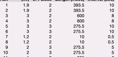

4- Last question Why when I am making the design again, now JMP chose two runs with 'X1' data points as 1.93 and 1.89 (two separate runs) that are not centered at all. X1 is set up as a continuous factor with a range of 1-3. I am okay with the decimals for this factor, however, I wonder why JMP chose those two values so close to each other instead of values more spread out apart in the experimental space?
Thank you very much @Victor_G for your fast and detailed responses!! Super helpful, thank you!!! I am learning  A LOT!

4- Very good question, and I don't have a clear answer. This is presumably because of coordinate exchange algorithm (used for custom design) and random starting/generating points for the design. As the design is generated from random points in the design space, the optimal repartition of points in the experimental space may change from one design generation to another. Hence you can see some slight changes in the values when generating again the design. You can manually change these values to the closest value (here 2) without changing the optimality of your design too much, or try generate again the design, eventually by augmenting the number of random starts and/or the design search time (in the red triangle close to "Custom Design" you will find "Number of Starts" and "Design Search Time").

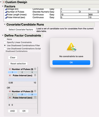

Hello @Victor_G again! I have a quick question; do you know why I cannot save my model constraints like we can do with the factors and responses?
thank you!

Victor_G
Re: Adding a complex constrain to a Custom Design with 4 factors
Hi @ADouyon,
It seems that you can save and load constraints only if it is done through the option "Specify Linear Constraints".
What you can do in your case, is
  1. to generate your DoE entirely with the constraint you added, and then you'll see that a new script in your datatable called "Disallowed Combinations" (see screenshot Disallowed_Combinations-datatable-script.jpg).
  2. If you right click on it, then click "Edit", you can copy the JSL code of the disallowed combinations (see Disallowed_Combinations-datatable-script-Edit.jpg) and...
  3. Use it (paste it) in the Custom Design creation, in the "Use Disallowed Combinations Script" option (see screenshot "Use-disallowed-combinations-script.jpg).
There might be a smarter and more automatic way to do this (via JSL scripting maybe ?), but this approach work (and you don't need to manually recreate your disallowed combinations).
Hope it will help you !
Victor GUILLER
ADouyon
Level III
Thank you very much @Victor_G! I just tried it and was able to do it
