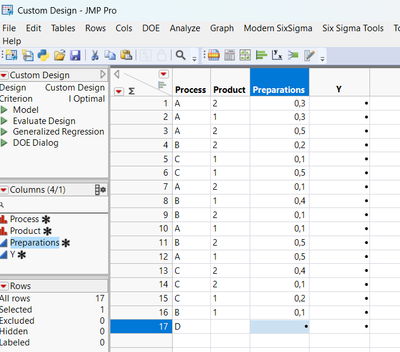

In your original DoE datatable, add a row with the new level you want to add for the factor column considered (don't add other values in the other factors columns) :

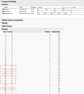

When using the Augment Designs platform on this modified table, JMP will recognize the added level and suggest new runs with this added level :
Note that you may have to run a lot more experiments if you want to keep the same RSM model. You can adjust this by specifying the estimability of terms involving Process factor as "If Possible" to reduce the number of runs required or else, you might need to augment the number of runs in your augmented design to avoid an error message "Optimal designer failed to converge" if you have insufficient runs in the augmentation to estimate all terms in your RSM model :
