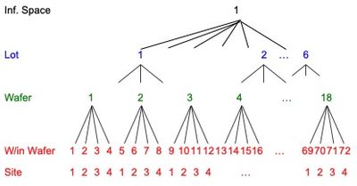

You are describing a nested (or hierarchical) sampling plan.  The sampling tree might look something like this:
As @P_Bartell suggests, looking at the data with variability charts is a good first step.  I'm not sure what you mean by "uniformity"? To understand consistency you can use Range charts.  Start at the bottom of the sampling tree (the smallest rational subgroup).  If this is stable, roll up the tree and assess the variability at the next layer.
