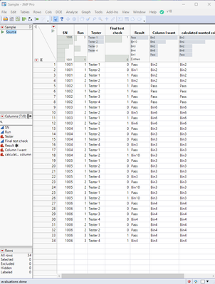

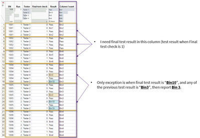

Add final test result column with one conditional exception.
How can I add final test result column with one exception mention below.
I apologize for asking same type of question over and over.
Thanks you

Re: Add final test result column with one conditional exception.
Thanks Jim,
This works perfectly fine for small set of data. When I used this on my actual data (4000 rows) it is taking forever to execute. Is there any way to make it faster?

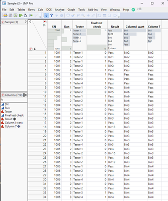

Thanks Jim,
It is much faster.
