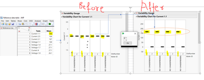

@txnelson
Below is the Screen short of the results that I am expecting. I have attached the final result data table
Here are the steps:
1. Read data table and reference data table
2. Generate a new window to select site number,
3. Based on the user input (Site Number 1 or 2), align those data to the reference data table values
 Take mean by wafer Id, apply the offset to the main data table
