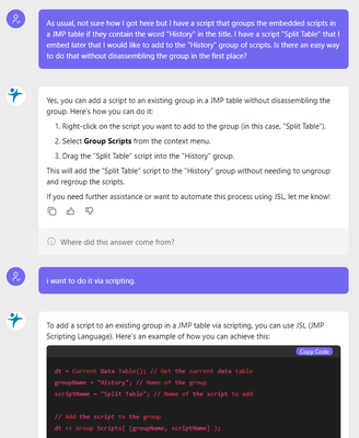

As usual, not sure how I got here but I have a script that groups the embedded scripts in a JMP table if they contain the word "History" in the title.  I have a script "Split Table" that I embed later that I would like to add to the "History" group of scripts.  Is there an easy way to do that without disassembling the group in the first place?
