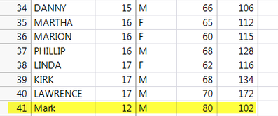

The result of this piece of code is shown in the screeshot below :
Shouldn't the row be added after row 1 - essentially moving rows 2 through 40 down ?
Can someone point out what i am doing wrong here?

The documented code works correctly.  I think what you are missing, is that the Add Rows() function has 2 different code structures, and that mixing the 2 structures does not work.
Add Rows(1) or Add Rows(1,3) is one of the syntax structures
and
Add Rows({list}) or Add Rows({List of Lists}) is the second structure
My testing of the code does not permit the mixing of the 2 syntax structures
