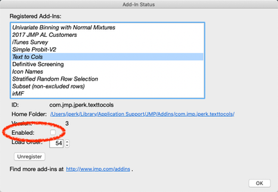

Jeff_Perkinson
Re: Add In limit?
Look in the Log window to see if there are any messages about trouble adding the menu associated with the Add In.
Also make sure the "Enabled" check box is checked in the View->Add Ins window.
