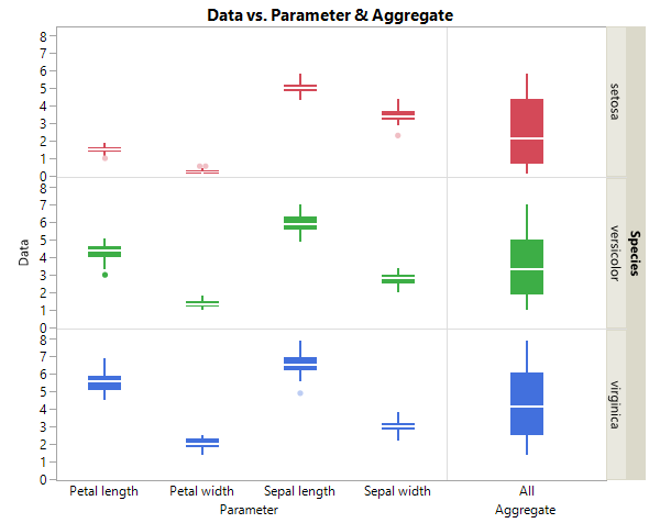

Hi all, I need to make boxplots groupped by a column value, but I need to also ADD a boxplot of all this groups together (as in no-grouping). Do somebody knows a nice solution for this?
I was trying some scripting with either graph builder or oneway but I haven't been succesfull.
Thanks!

One method is to create a stacked data table, stacking your variables and creating a placeholder column called Aggregate.
The Iris sample data table is not the best example, but here goes. The variables Petal Length and Width and Sepal Length and Width are stacked. An Aggregate column is created with value "All" then GraphBuilder can be deployed with one Y-variable the stacked data; and two X-variables, the (1)Group/variable names and the (2)Aggregate column.

I added two features, the relative spacing of X, and for the heck of it because it makes sense for this data set, I used Species as a Y Grouping factor and Color. See below.   Good Luck.

Thank you very much, it perfectly solves my problem. I had the table already stacked properly to make the box plot, but the new column with ALL does the trick perfectly.
Kudos!

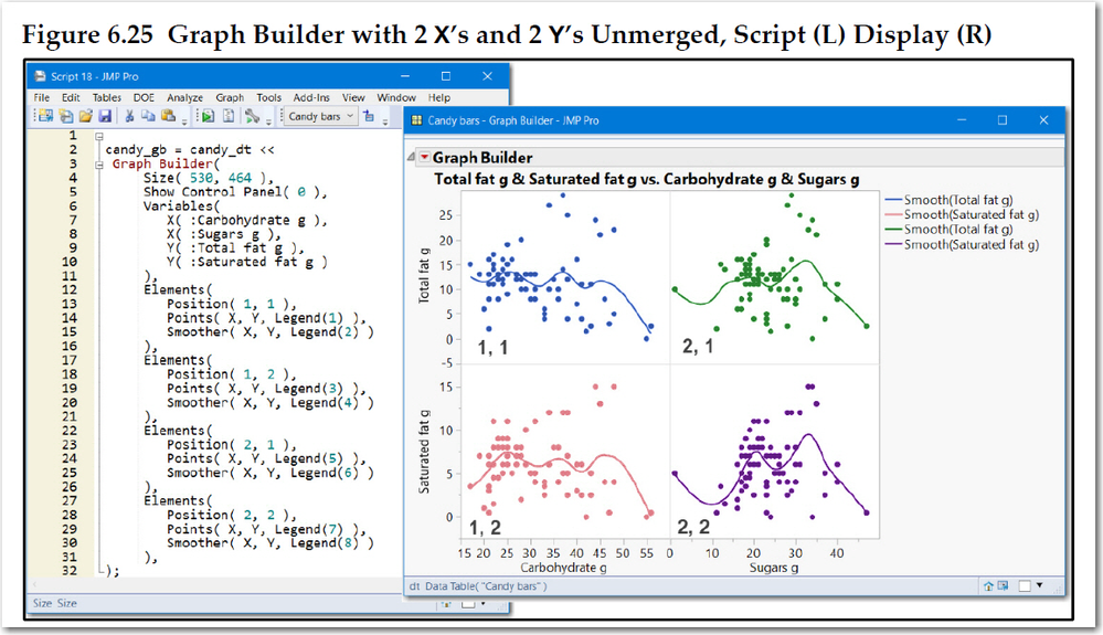

Below is a figure from the book that shows a script using Candy Bars.jmp, a JMP sample data table.  It shows a GraphBuilder with 4 panels, 4 graphs made from 2 Y's and 2 X's. It depicts how position determines the layout. This can be done via the UI by dragging 1 Y and 1 X to the  respective axes. The drag andother X to the right of first X and another Y to just below the first Y. Hope that helps.
So please provide more details about what you are looking for.  I don't think I used any Excel files for this script.
