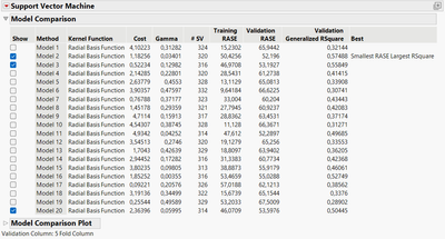

    In this example for illustration, I used the JMP Diabetes dataset and the SVM platform. I realized a tuning design to find 3 appropriate hyperparameters settings (models 2, 3 and 20) :

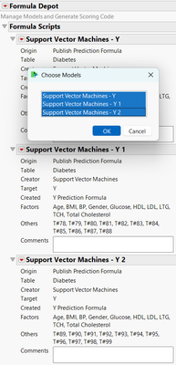

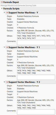

  3. I then press CTRL + click on the option Publish prediction formula (available in the red triangle next to any model). A new Formula Depot window is created with the formula of the three models seen earlier :

  4. In the red triangle next to Formula Depot, I click on the option Model Comparison and select my three models :

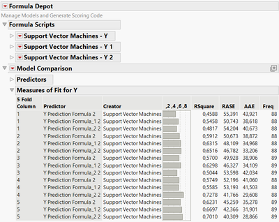

    JMP notices than my 5-folds validation column is used for all models, and ask if it can use it as a grouping column, so I click yes to have individual models results for each fold. 
  5.  I have now access to the individual folds measure of performances for each of the three models :
This method should work no matter the modeling platform used, as it is only using the models prediction formula, so you can combine different models types.

Hi Victor,
This works! Thank you very much!
