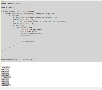

Thank you, I'll definitely be using the concat function. My big problem is taking in the user input. They'd be copying a column from a datatable and pasting it into an edit box. In my current code (seen below), it'll only take the first cell of the copied column... I'm assuming this is because I'm using a "Text Edit Box" and the Text data type - is there an edit box and data type that could take data formatted like this?:
A1234965 A1233339 A1234736 A123494Z A1233114
Here's my current code:
Lots = "abc";
w = New Window("Lot(s) of Interest",
Border Box(top(50), bottom(50), Left(50), Right(50),
V List Box(
H Center Box(Text Box("Lot(s) of Interest Input")),
Spacer Box(size(1, 30)),
H List Box(Text Box("Lots: "), b1 = Text Edit Box(Lots)),
Spacer Box(size(1, 10)),
H Center Box(
Button Box("Save",
Lots = b1 << get text;
w << closeWindow;

Thank you, this helps tons. I'm still having an issue converting the input into a list, formatted like so: {"aa", "bb", "cc"}. I would've thought the words function would work right away, as the input is just a long string.... but I'm probably doing something wrong. I attached a screenshot of my log.
You missed including the appropriate delimiter in the Words() function. In your case you want an end of line character (or characters) as the delimiter. See the table of Escape Sequences for Quoted Strings in the JSL syntax rules.

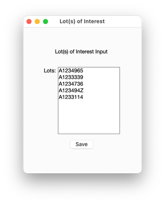

Try this:
Names Default To Here( 1 );
Lots = "abc";
w = New Window( "Lot (s) of Interest",
Border Box( top( 50 ), bottom( 50 ), Left( 50 ), Right( 50 ),
V List Box(
H Center Box( Text Box( "Lot (s) of Interest Input" ) ),
Spacer Box( size( 1, 30 ) ),
H List Box( Text Box( ("Lots: ") ), b1 = Text Edit Box( Lots, <<SetNLines( 10 ), <<set width( 150 ) ) ),
Spacer Box( size( 1, 10 ) ),
H Center Box(
Button Box( "Save",
W << close window; //include the delimiters for carriage and new line in the Words() function
newlots = Words( Lots, "\!r\!n" );
Show( Lots );
Show( newlots );

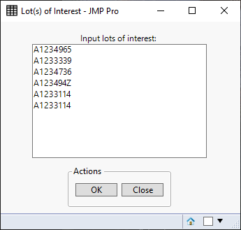

Like I said earlier, use Words() to split it into a list. Then use Concat Items() to combine that list back to a string. It might be enough to use \!N as separator with Words() but sometimes it might not work correctly
As this can be fairly common task to do with JSL below is complete example. This example does contain some a bit more advanced techniques which can be used when building user-interfaces with JSL, so it is a good idea to start with the example @jules provided first.
Names Default To Here(1);
lotquery = ""; // initialize as empty
initial_input = "A1234965
A1233339
A1234736
A123494Z
A1233114
A1233114";
nw = New Window("Lot(s) of Interest", Show Toolbars(0), Show Menu(0),// << modal,
Border Box(top(10), bottom(5), Left(20), Right(20),
V List Box(align("center"),
Text Box("Input lots of interest:"),
Text Edit Box(initial_input, << Set NLines(10), << set width(250)), // << Set Text Changed or << Set Function can be used for cleanup during input
Spacer Box(size(300, 10)), // Use wide spacer box to easily force window width
Panel Box("Actions",
Lineup Box(N Col(2),
Button Box("OK",
<< Set Function(function({this},
Local({input_values, input_list},
input_values = (this << top parent)[Text Edit Box(1)] << get text;
If(IsMissing(input_values), // very lazy check
Throw("No lots provided!");
input_list = Associative Array(Words(input_values, "\!N")) << get keys; // aa to remove duplicates
lotquery = "'" || Concat Items(input_list, "', '") || "'";
write("Input lots: " || lotquery);
(this << top parent) << Close Window;
Button Box("Close",
<< Set Window Icon("WebBrowserImportAsData")
/* // if modal is used
If(nw["Button"] != 1,
Throw("Cancel pressed");
If(IsMissing(lotquery),
Write();
