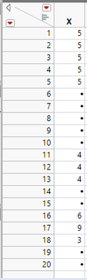

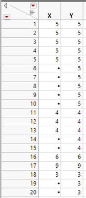

having issue implementing formula/script using lag function that will help populate a new column where original column has some missing data. so if rows 1-5 have x value and missing readings from 6-10 and a change in row 11 so rows 6-10 would be that x val

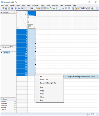

Besides using Lag() if your data is fairly simple and you want to only fill missing values by repeating earlier value, JMP does provide interactive option "Replace Missing with Previous Value"
