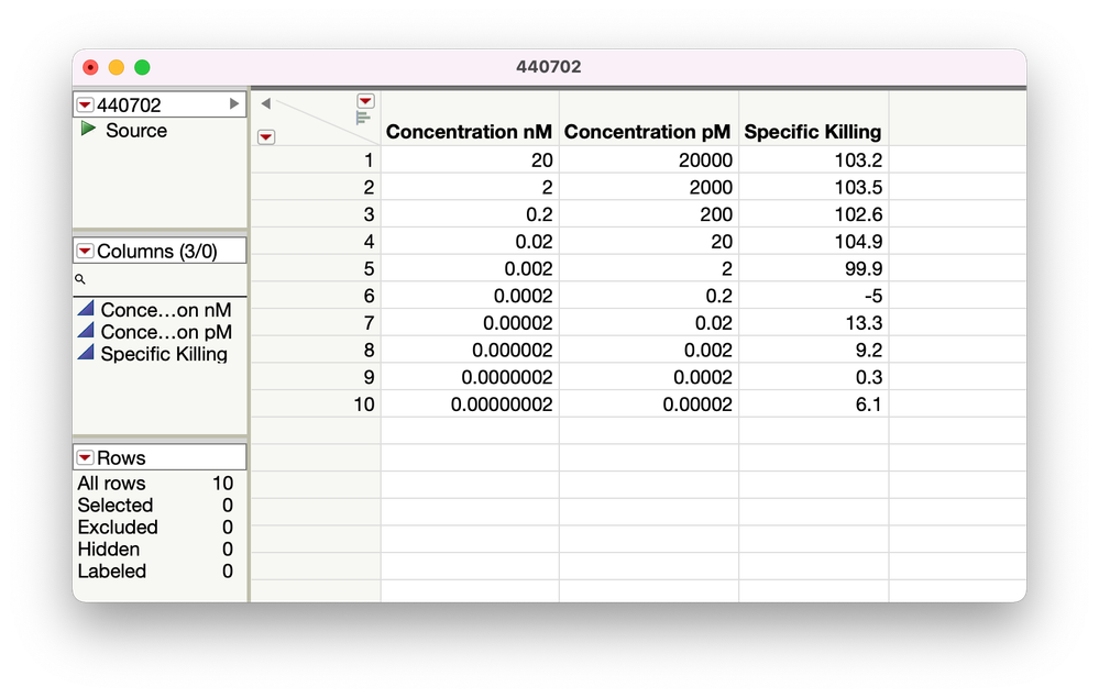

I used JMP: File > Internet Open > Web Page to create a JMP data table from your example.

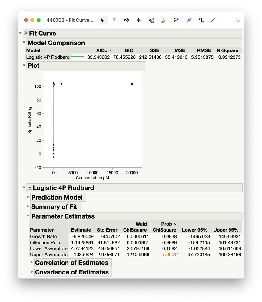

Here is the fit using Analyze > Specialized Modeling > Fit Curve and the Rodbard model with Concentration in nM.
Here is the same analysis but using Concentration as pM:
You can see the problem right away. The sigmoidal shape is not visible using either units. This situation leads to unstable estimates. I tried a log10 transformation, but it does not help. You have an abrupt change in the response between 2 and 0.2 nM, and so the sigmoidal shape is not observed. You would presumabley have to expand the concentration between 2 and 0.2 nM to define the transition better on order to use this model.

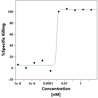

Actually, if you change the visualisation of the scale, (using a log visualisation of the axis without log transformation for the fitting), we indeed have a good fit, as you can see below:
(But my thinking can be wrong, I am not a mathematician :).)
However, your second point make sense to me, it is true that for this sample, there is a big gap between 2 and 0.2pM, whcih could be an issue for the approximation of the inflection point.
