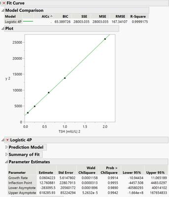

I am trying to get to the bottom of an odd observation when trying to fit data using a 4PL. In short, when I fit my data I end up with a flat line:

Here is the resulting fit:
Regardless of whether this is the correct fit to use for this data set, it is strange to see this odd behavior. If there is another explanation other than a bug/glitch and someone can explain that would be amazing!

It is an intriguing finding indeed. I wonder if the cause of this is related to the fact that your data appears to fit almost perfectly a linear regression, leaving no space for JMP to estimate the inflection point in your 4PL fit. Just a thought but no obvious solution here.

Thanks for the reply. I completely agree the data is fit very well with a standard linear regression, and chances are when we have a more complete dataset to fit this won't pop up (fingers crossed!). It was more puzzling due to the small changes to the numbers themselves or the orientation of the data within the table resulting in JMP being able to fit the 4PL. A few other notes to add to the weirdness:
  • a 5 PL fit works fine with the data in the orientation that does not work for the 4PL fit
  • Duplication of the data so as to simply have 10 rows, N=2 duplicate rows for each entry, also results in the 4PL fit working.

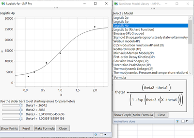

Dear @P_Desmond , I agree, that the behaviour is not correct, perhaps there is some singularity in that algorithm with your first dataset. You can send your example to the JMP support support@jmp.com
But please recognize, that for excactly your example data, logistic 4P is not the best model.
In that example below I used the manual fit Logistic 4P (nonlinear platform), to have a picture, what the curve typically looks like. Choice of model always is crucial.
