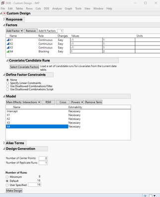

Hi @Luca_Indrizzi,
From the screenshots you give, everything seems normal to get to the results you expect.

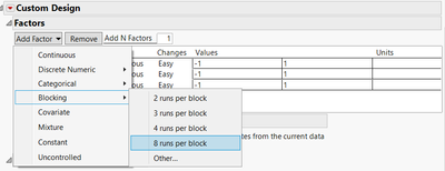

How did you set up the blocking factor ? Did you set up as 8 runs per block (to have a 2^3 factorial design in each block) ? :

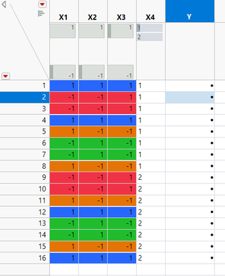

If yes, specifying 16 runs and main effects in the model should give you what you expect :
Here is the script if you want to generate the same design :

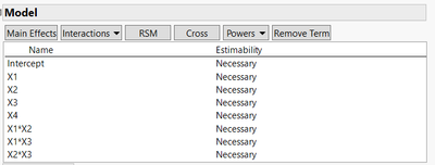

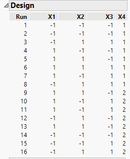

If you want to have the full factorial design, you need to specify 2-factors interactions in the model, and with the same procedure, you'll end up with the full factorial design replicated once in two blocks like you expect :
Here is the script to generate it :

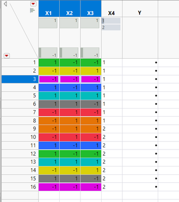

Hi @Victor_G
Thank for your reply.
Exactly, I set 8 runs per block.
But what you and I got is a replicated 2^3-1 design in each block, since for ex. 1,1,1 appears twice in block 1 & 2, but for ex. -1,-1,-1 doesn't appear at all. What I would like to have is that block 1 & 2 contain each the entire 2^3 factorial design.

You need to specify in the model the 2-factors interactions in order to get the full factorial design :

The results from Custom Design depend on the model you specify. In this case, Did you specify all 2-way and 3-way interactions. My result is what you asked for.
