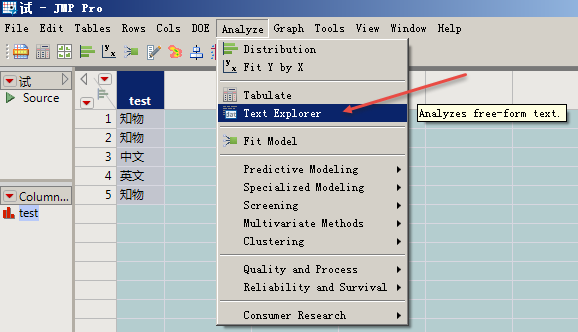

在"文本分析器"模块中、用户自定义的词库如何加入软件的默认词库中?
大家好!
我使用的中文版、我找到了软件的默"文本分析"模块默认词库文件、在文件中加入了自己的自定义词库、但在分析时这个新增加的词不起作用。
请教专家:在"文本分析器"模块中、用户自定义的词库如何加入软件的默认词库中?

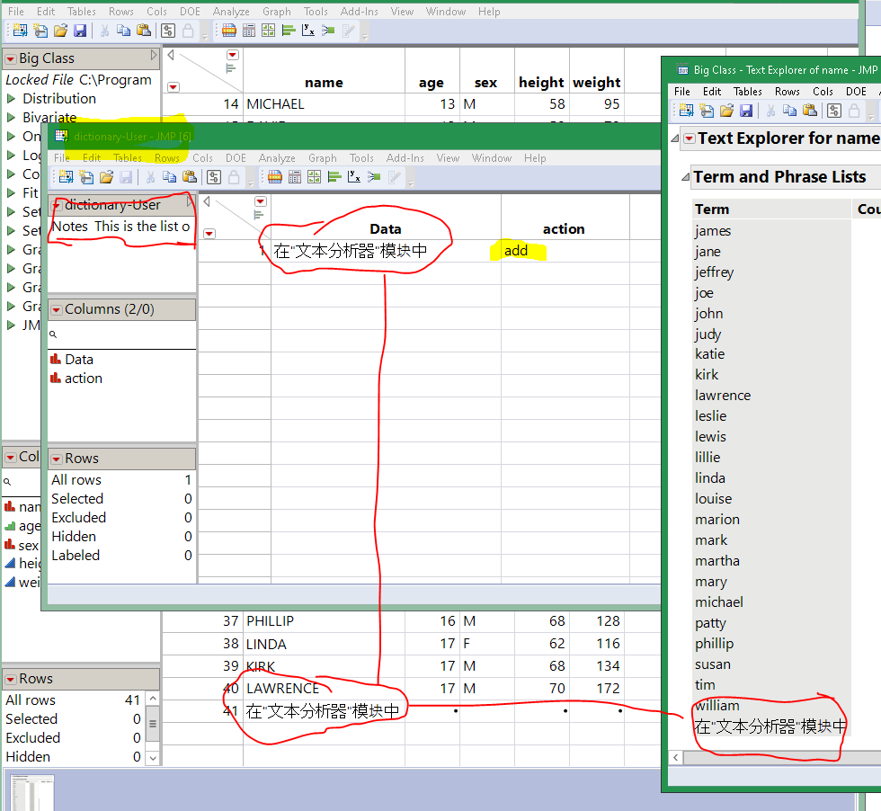

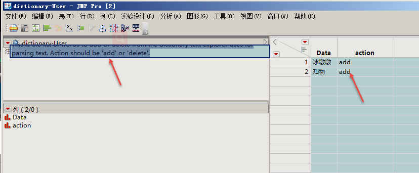

The user dictionary has an "action" column. use "add" to add words. The notes for the user dictionary has a little more detail.
user dictionary notes says: This is the list of words to add or delete from the dictionary text explorer uses for parsing text. Action should be 'add' or 'delete'.user dictionary notes says: This is the list of words to add or delete from the dictionary text explorer uses for parsing text. Action should be 'add' or 'delete'.

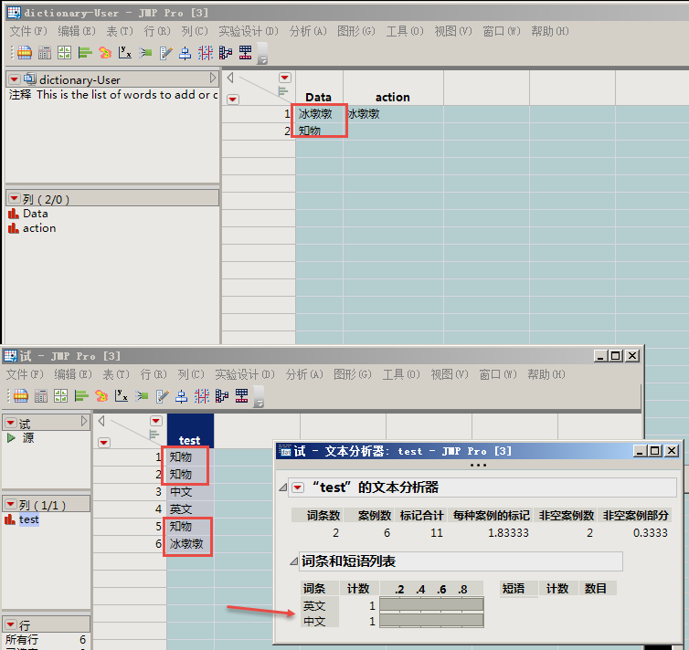

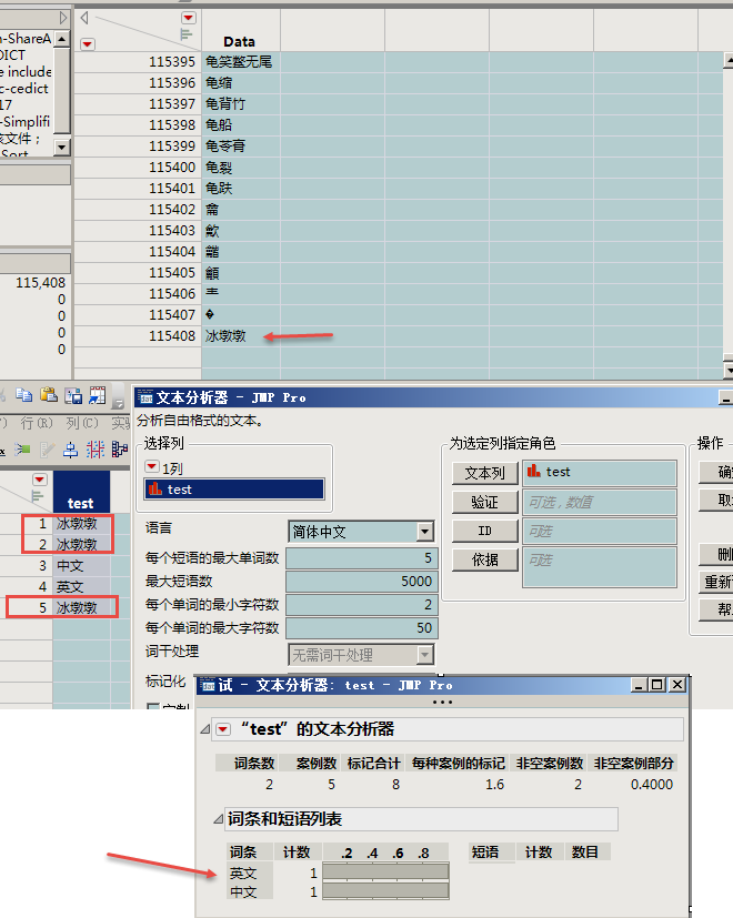

例如、我直接这个默认的词库中添加了一个自定义词。
当进行含有这个 新词的文本进行分析时、这个词不能出现

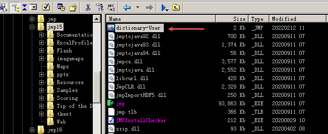

Try using the file named dictionary_User.jmp in the same directory.
Make sure you restart JMP after changing the dictionary. The dictionary is only loaded once, the first time it is needed.
Craige

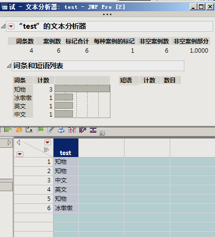

我试着这样写入两个自定义词、但分析时仍然没有起作用

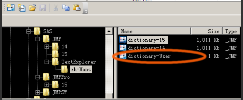

这个用户文件、我放在两个文件夹都试过。还是没有成功。
Craige_Hales
回复: 在"文本分析器"模块中、用户自定义的词库如何加入软件的默认词库中?

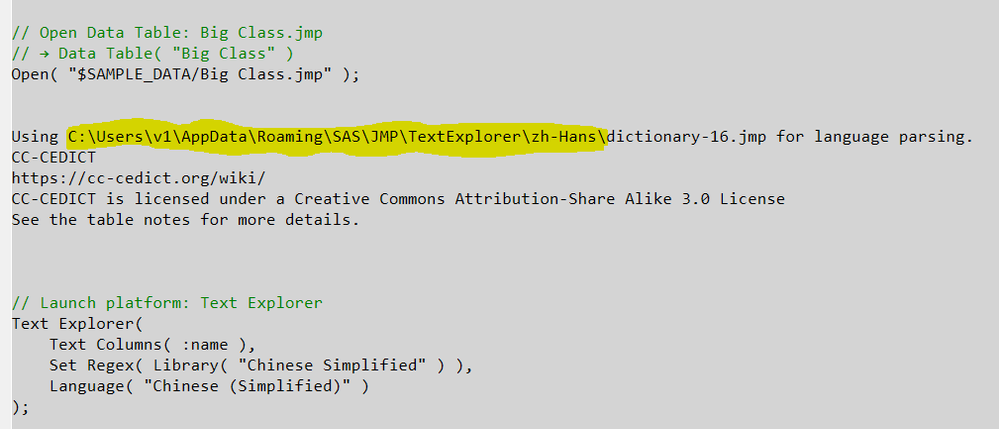

The tiny user dictionary is in the same directory as the downloaded dictionary.
The path is printed in the log when you use Text Explorer.The path is printed in the log when you use Text Explorer.You found it here.You found it here.
Restart JMP after making changes.
可以了、感谢专家的帮助。
我粗心、没有仔细看这个文件中的说明。
