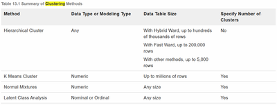

  1. If you have data with mixed data and modeling type (numerical continuous, ordinal and nominal), then only the Hierarchical Cluster platform will be able to handle such various data type. You can have more info here, Overview of Platforms for Clustering Observations where this table is shown :

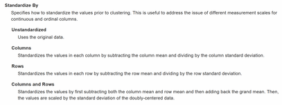

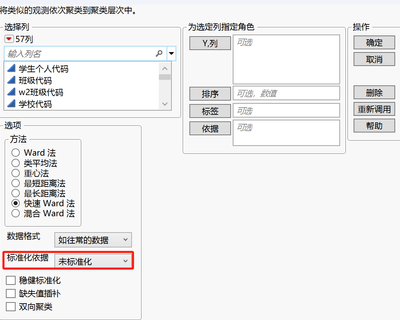

Question 1: Since my data contains mixed types of variables, it is indeed necessary to perform hierarchical clustering. Furthermore, following your advice, I carefully reread "Launch the Hierarchical Cluster Platform" and found the solution: To address the issue of different measurement scales for continuous and ordinal columns, it seems I should standardize the continuous and discrete variables first, and then select "Unstandardized" under "Standardize By."Standardize By

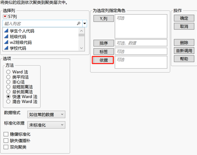

Question 2: Your understanding of my doubts was very accurate, and your response has given me important inspiration. In fact, I aim to use cluster analysis to discover different clusters within a vast dataset (individuals) and to conduct visual analysis to explore the potential relationships between more than twenty variables, which is an unsupervised machine learning task. However, to obtain more ideal clustering results, it seems that choosing a certain binomial variable under "By" yields very satisfactory clustering outcomes. I am pondering whether this has now become semi-supervised or supervised learning.By
