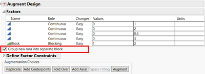

Simon: if I already have existing DSD data and I want to augment them to a full RSM, how do I deal with the lack of randomization since I add on additional runs which I didnt measure together with the first data set?
Victor: Use blocking when augmenting the design
Phil: FitDSD will not work with missing runs unfortunately
Simon: can you show the augment using blocking in the software?
Victor: I added this default check in the Wish list: https://community.jmp.com/t5/JMP-Wish-List/DoE-Augmentation-Option-quot-Group-new-runs-into-separate...
