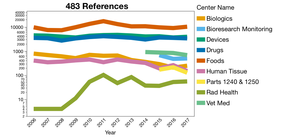

The raw data, with 18,737 rows, alone is accessible and interesting to look at (Figure 1). I adjusted the y-axis to a log scale to visualize all the trends together. The construction of the graph requires the use of the frequency column. There are a couple of potential trends across the Center Program Areas, for example, Radiation Health citations jumped up around 2009 and 2010, and Citations for Human Tissue and Biologics are trending down.  Be very careful in assigning cause to trends. Biologics might be down because blood product suppliers have consolidated and there are fewer sites to inspect, or maybe the industry has gotten better (I hope so).
Figure 1. Counts of 483’s by Center for 2006 to 2017. Graph of the raw
 imported from the database files

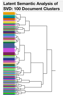

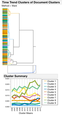

I started with Text Exploration. This is a word frequency (bag-of-words) approach to trying to understand what is in the documents. To group similar documents, I used a Singular Value Decomposition for a Latent Semantic Analysis (Latent Class Analysis or LCA). I centered and scaled the vectors and used TF-IDF weighting and then used a hierarchal clustering method to classify 100 clusters of documents. To find trends over time with each of the 100 clusters, I used a second rouind of clustering where I used the year as the attribute ID, LCA cluster as the object ID and clustered by the frequency of the LCA cluster. This hierarchal clustering approach finds groups of documents with the same frequency trends over time (Figures 2 and 3.)
Using classification and cluster approach, we have narrowed down our search for trends in 4,167 documents to 283, and we can classify those documents with three Time Trend Clusters and a total of seven Document Cluster (LCA) groups (Table 1.)

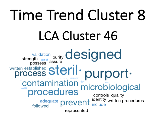

With the documents grouped by time trend, the next problem involves trying to understand the contents of the documents we have identified. I could read the 283 long descriptions, and again, that might be interesting but tedious. Instead I'm going to go back to text analysis to try to understand what these citations are about. As it turns out, word frequency, often represented in a word cloud, is a quick method for deriving insights and then letting our brains work out the pretext based on our familiarity with the context. In these word clouds the size of the word is proportional to the frequency it occurs and the darkness of the word is indicates the frequency of the document. If the word is darker it was in more documents, but if it is bigger, then it occurs more frequently in documents. Text analysis used in this context is imperfect, but it is more practical than the alternative of manually processing each document individually (Figure 4, 5, and 6.)
Figure 2. Dendrograms from Clustering Operations. All of the 4167 documents from the Drug Center were clustered into 100 Document Groups using Latent Class Analysis (LCA) (1st panel). To find groups of documents that occur with similar frequencies, a second round of clustering was performed. The 100 document groups were summarized into 9 Time Trend groups (2nd panel). Clusters 3, 4 and 8 have patterns that begin to increase in the last years on the graph.

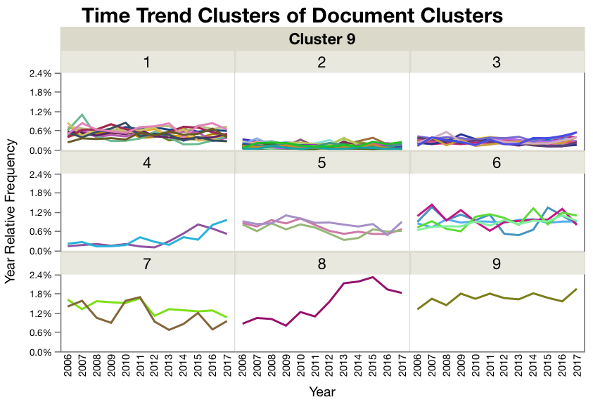

Figure 3. Document clusters within each time trend cluster. Most of the time trend clusters are pretty flat or have low frequencies like cluster 1 and 2. But clusters 3, 4, and 8 have some interesting upward trends in the last couple of years. (note the lines are colored by document cluster, and the color has nothing to do with cluster distance.)
Figure 4. Time Trend Cluster 8. The largest trend is in Time Trend Cluster 8 where the documents are related to sterile processing and contamination.

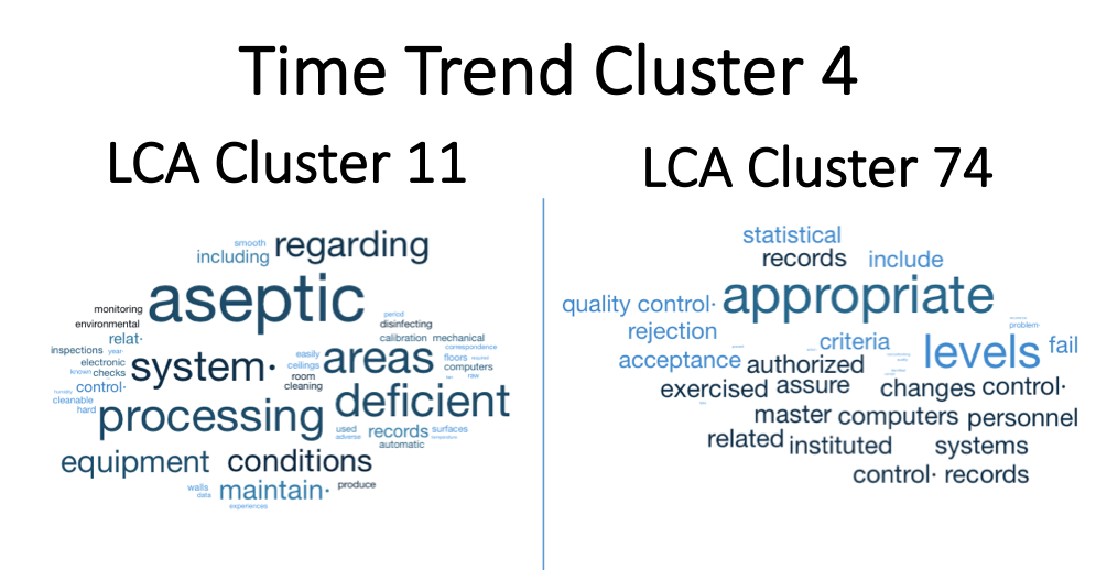

Figure 5. Time Trend Cluster 4. Time Cluster 4 has the next largest increase in frequency of citations. The documents in the document cluster 11 are again related to aseptic processing. Document cluster 74 are related to appropriate levels of authorization and control of controlled records.

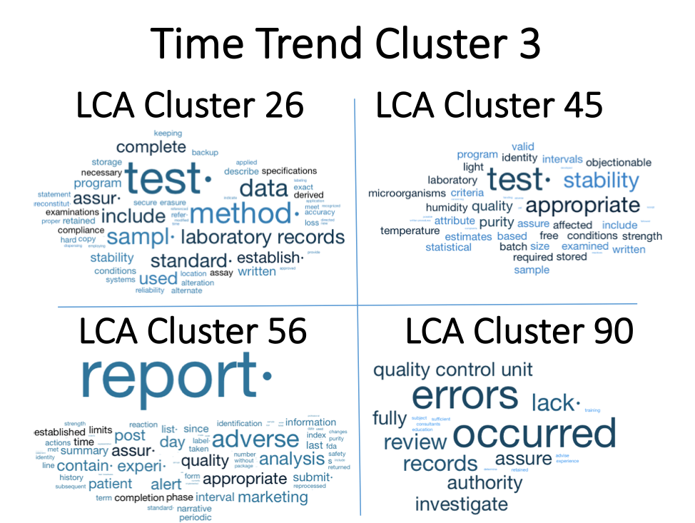

Figure 6. Time Trend Cluster 3. The time trend cluster with the smallest upward trends is cluster 3. Document clusters 26 and 45 are related to test methods and their general lack of robustness with respect to procedures, standards, sample handling, and their standards and controls. Document cluster 56 is related to citations around reporting things like adverse events at multiple stages of a drugs development and licensure. Finally, document cluster 90 is related to the lack of control of errors and how they were dealt with.
