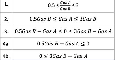

- In addition, the experimenter wanted to bound the ratio for two of the gases between an upper and lower value.
- The third gas, C, was to make up no less than 10% and no more than 25% of the total mixture.
