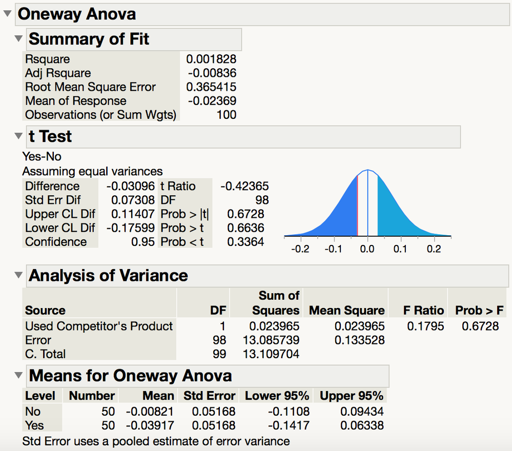

Figure 3. Results from t-test on change scores.
