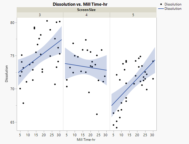

Figure 17: Dissolution vs Mill time-hr for all three values of Screen Size, with Lines of Fit depicting positive correlations for Sizes 3 and 5, but no correlation for Size 4.
